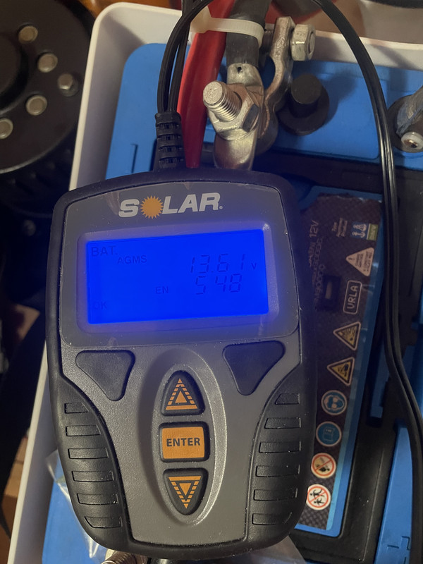

I use one of these to test the health of my batteries…I did this test yesterday on my bow thruster batteries
the 552 amp hour is good because the battery is only rated at 450
