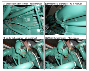

On the subject of AI, I have just spelt a fruitless 30 minutes trying to find out using AI.Where on earth the coolant drain plug is on the starboard side of my tamd 41 because i'm scuppered if Ihear find it. Contributors to this topic may be pleased to know that AI was absolutely 0 use - if any of you reading this could help me by telling me what it's next to that would be most helpful as I'm pulling my hair out !
