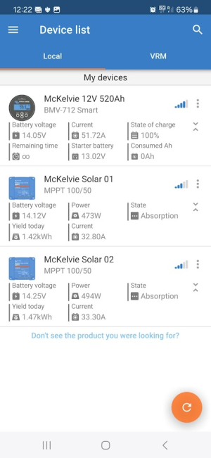

We have 4 x 315W Half-Cut bifazial panels each at 35-42V (Total 1,26kW) on a solar arch on the stern ... they are currently feeding a bank of 4 x LA Gel batteries (520Ah). Panels are in a 2/2 series/parallel configuration. They are limited mainly by what the LA batteries will accept but here they are delivering around 1kW in the Adriatic - almost 3kWh generated by midday.
I went for 42Voc panels because my Li setup will be 48V .. need a bit of headroom above Vbatt for the MPPTs to function efficiently.
Next phase is to add the 10kWh of 48V LiFePO4 batteries, a 5kW inverter charger, and an Integrel 48V, 9kW generator. Will probably see more from the solar once the MPPTs are feeding Li instead of LA.
PS - For the pedants, this screenshot was taken before I set up the BT network that allows sharing of Vbatt by the shunt ... now they all see the same Vbatt and charging is coordinated between the MPPTs.
