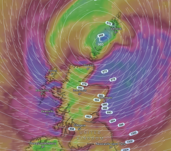

Below is the EMCWF forecast for Easter morning for the northern UK. And it will be unrelenting rain, and a temperature between 2 and 6°C.
