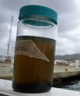

My diesel is totally clear so to me that looks like a lot of stuff in the diesel especially if you have just cleaned the tank , fuel and filters so all should be totally clean.
Sadly I use a lot of fuel and in mallorca most places have a huge fuel turnover so maybe that is it. Others will have a view but to me that does not look that great.

Acting /advising in your best interest ,get the team to do basic checks --MBY have some great engine vids ,from memory it's even a KAD 44 -perfect .
Fuel sample
That's contaminated for sure !
A few 100 L sucked through those filters will capture the crud ,this means regular filter changes even initially @ every fill up of 2nd fill up for a while .
Remember the filters have to deal with more than the consumption because a lot is returned in your case cleaner .
Keep dosing with additive too every fill up .
Pete 2x filters less than £20 ,additive same ish --say 3x£40 for 3 fill ups --£120 ---well worth it compared to grief with pump and injector woes + hassle .
When it's spotless then replace the engine filters before shipping off to the Med .

Thing is Porto, the 60 hour old filters (15 hours since we've owned her) weren't overly dirty when they were removed and replaced. Anyhow we've got three sets as spares now and the filters will be checked again when the boat is serviced the week after next.
Re the fuel sample Pete, assuming it was drained from the bottom of the pre-filters I would say that is not unusual on a boat of of that age.
We have just sold our boat (1992 model) and every year I would take the tap out of the bottom of the filter bowl and flush the filter housing through. Always got quite a bit more crud than that but never had a problem at sea, even when it got a bit lumpy. We did polish the fuel in the tanks one year and it was quite enlightening to see what got caught in the filters of the polishing system.
It was similar on the boat before that as well.

Just for people's interest and amusement, this is the fuel sample taken from a boat THAT WE DIDN'T BUY. Amazingly it still performed as per the original spec on the sea trial.
Estimated cost to have the tanks cleaned and fuel polished was €5k.

And this is the latest bowl full of diesel I have just drawn from my engines, yuk!
Have been adding Marine 16 and changing filters for months now but I suspect I am losing this battle and will need to get my tank cleaned when we get back to Blighty in a few weeks!

Eeek, that doesn't look good! Where's the boat based? How as the sample taken?
Our boat is currently in Hythe and google threw up SAL Marine in Lymington as a firm that would add inspection hatches, clean tank and polish fuel. As per my earlier posts, they checked the condition of the tank via the sender aperture and confirmed they looked OK. They changed the filters at my request (I'd have changed them at the imminent survey anyhow). the full job would have been about a day's labour @£55ph plus £200 for filter. All plus VAT I suspect.
Subsequently, the local (non-VP agent) engineer recommended SDM (http://sdm-fuelsolutions.com/ ) and said they were the ONLY company that he would use so they may be worth a try.

Greg, you make an important point there. Yes, my fuel sample was drained from the bottom of the two pre-filters, where it had rested overnight. In fact, after a few minutes of being in the glass, the sediment settled to the bottom and was almost imperceptible. Unless you looked very closely I don't think it wold be noticeable in the bottom of glass filter bowls. And as Porto correctly points out, in 6 or so hours of running the 500 litres in the tank could have been through the filters multiple times as a result of unspent diesel returning to the tank (I could be wrong there).
If there was that much sediment suspended in the body of the tank that might be a different matter.
Pete, your engine pre-dates common rail or unit injectors I believe, and is mechanical, therefore I don't believe it will be returning much hot diesel back to the tank. No bad thing there! Your diesel sample looks no worse than mine, and to date I have not suffered any issues. I would file this under "There are other more important things to worry about".

Whilst I always find debris in the bowls, when I go on to empty the secondary filters from the engines when changing them it is inevitably debris free so I work on the basis that the filters are doing their job. :)

That sample was drained from the bottom of the primary filter bowls after a short lumpy ride with the tanks only about 1/4 full so expected a bit. I have had no engine issues as yet but will keep adding the fuel treatment and changing filters until we get back.
We are based in Poole but will be up the Hamble river for the early part of the winter to get a new set of covers made so will look to get the tank drained, cleaned and the fuel filtered and returned then.
As others have said, your particular case doesn't look so bad and you may find the after a few tanks consumed then the filters may do the job for you.
