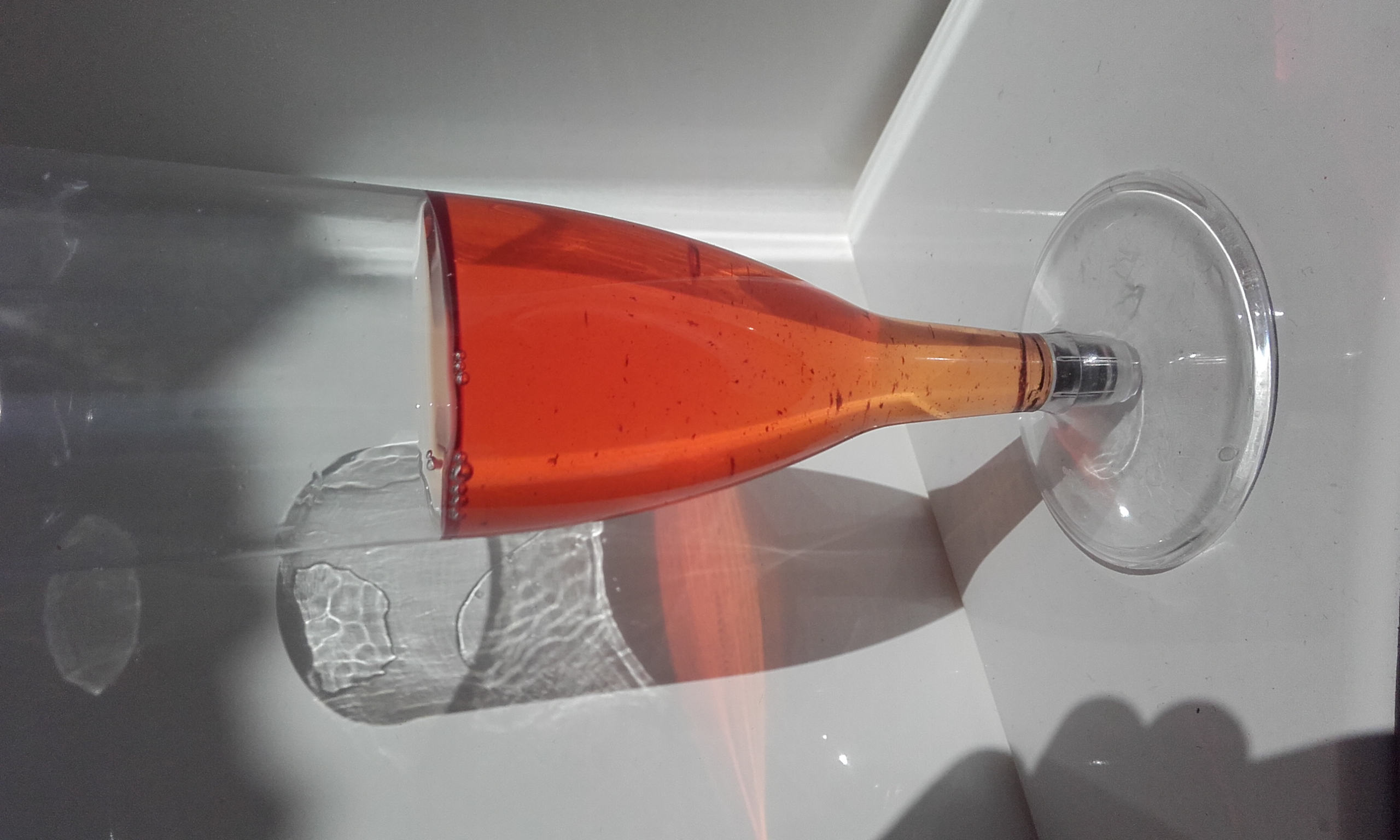

After Jez crewing and coaching my partner yesterday, today it was my turn to man the lines and fenders for my partner. Before we headed out we made a thorough check of the engines. Firstly, we drained off a little fuel from the filters. There's still a little bit of sediment as you'll see from the attached photo (sorry it's got rotated).
I'd be interested to know if you guys think this look OK.

Draining fuel into wines glasses. Now that is proper posh :)
