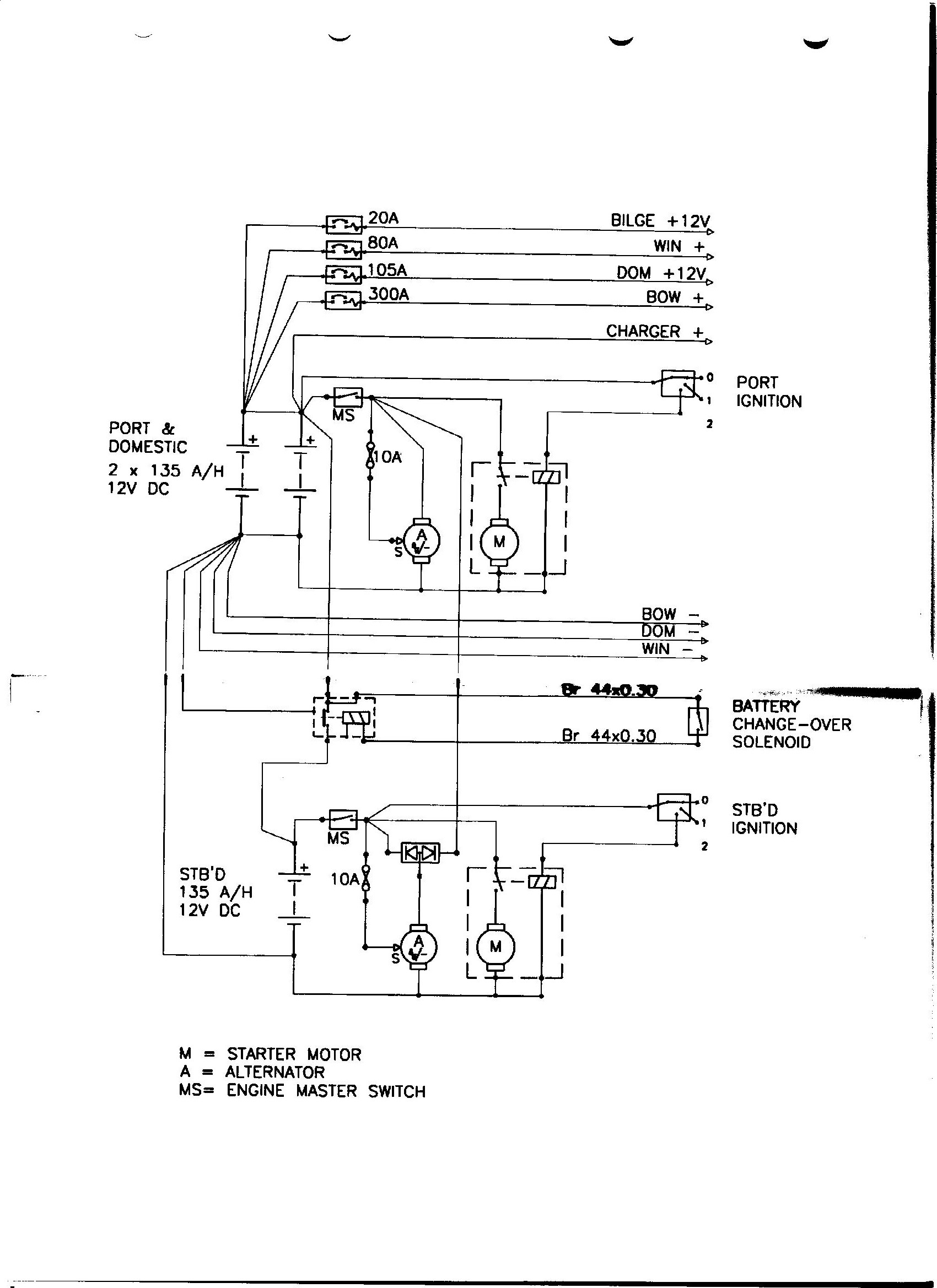

I've looked at the wiring diagrams and they don't show the ECU, power trim or steering pump being powered from the batteries, could they be powered directly from the alternators?

Do these engines have ECU's? Are the electronic or mechanical fuel injection systems? I can't see any ECU's on Pete's wiring diagram, unless that is a separate diagram?

Engines are KAD44P/EDC's which have ECU's.
There are 10 wiring diagrams but none of them mention any of the engine's VP electrical systems (power trim, ECU, etc). I assume the power trim etc are all in the engine's wiring loom so not in the Fairline documentation.

Stb engine has dedicated bat --that's good and there seems to be "bat change over solinoid " that's sensible too .
Just digressing when in the med after a long period @ anchor avec two fridges and poss an overnight ,start the Stb engine 1st as this bat in theroey should be almost fully charged .
If the port engine struggles to turn hit the x -over switch or "bat change over solinoid " ---same function
Ck the bat connections to the Stb bat first
Then the alternator function --although as I Infered what exactley is the warning light supose to do --as at the mo it's off suggesting the Alts working ? And you can see 14 v when revved up .
Capitol M thingy ?
I just assumed as the symptoms described thus far --come on when extra demand is placed on the stb bat
Nope, that's Starter Motor.
Yep but we know there's an ECU somewhere on that engine - it does not matter where .
Looking at the diagram it seems the Stb engine is NOT on the shore power charger ( port eng + Dom only )
This means the only way to top that up is indeed by alternator .
That's maybe why the engineer suspects alternator ,the Stb one of course .
But it's kicking out 14 v and the light /alarm is off .
Strange -- a said ck the conections
Yep dedicated s/b engine battery is not charged from charger, only alternator (manual confirms this).
I have no idea why this is but JtB confirmed same design on his T40.
Yep, that's the conclusion I've come to!
