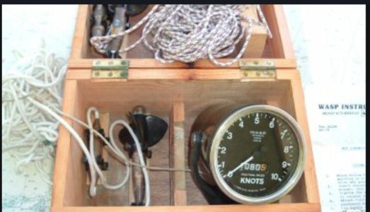

And this is the Wasp log I bought 20 years ago on eBay in its wooden box complete with two spinners and instructions. Still works.

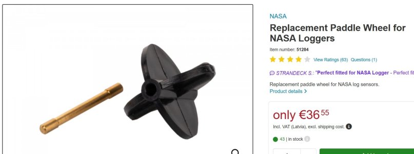

If your PW log stops working ... try this ....
Turn it 180 degrees in the through hull ... it does not care despite some having an arrow showing FWD .. the magnets passing the reed are the important bit and makes no odds which rotation ... CW or CCW. It may just start to work - having the PW now being 'pushed' opposite direction.
On every log I’ve used the paddle ‘blades’ are asymmetrical with a flat face only on the forward side. Turning it around 180 degrees would likely lead to chronic under reading.
I have NASA ... Echopilot .... B&G .... they do not have as you say - turning them around would not cause such.
But lets say you have such ... turning it around - may just be enough to dislodge what is stopping it working ... once turning again - turn it back to arrow fwd ...

A late friend had one of those many years ago. One day it was still deployed when he put the engine into astern. I have it on his authority that this is something you shouldn't do.
We trail lures for tuna and mahi mahi in the tropics. The wasp log would be useless unless it had a fishing hook on it🙂
