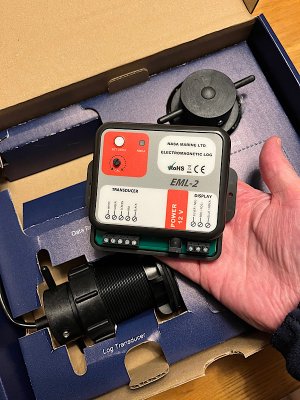

My log has turned up, the control box is bigger than I thought but looks straight forward.
I’d like to test it before fitting it, when wired into the boat do you think putting the transducer in a bucket of water and swishing it about would give me a reading?
I'm sure swishing it around a bucket would give you a reading. When operational it will read the tidal flow down to .1 or .2 of a knot. Just how accurate it is at those readings is questionable but it seems to match observations.
Good choice...
Edit: PS it may need to be salt water, not sure if they work in fresh or not...

Running it under the tap didn’t work but swishing in a bucket did. Sensor works and integrates with a Tacktick system perfectly.
Will fit it next month.
