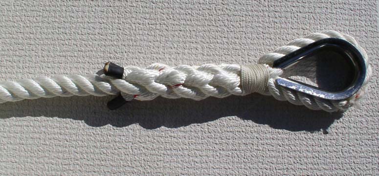

If for some reason the finished eye is to large to keep the thimble captive, a whipping at the throat like in this picture can be used.
Found this pic on the web :)
