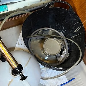

There is no need to panic . Just get the contaminated oil out using a Pelo or similar. Put some fresh oil in to flush out bearings and. Passage ways and remove this and fill with fresh oil. We had a boat in our marina that contaminated his oil 5 times before he found the source and the engine did not seem to suffer .
Right, I think that’s the oil dealt with for now. It’s had about 14 litres thru it and then a final change. Four filters and about 20 minutes of running, in short runs. It sounds pretty good, starts on the button, smokes as expected but looking hopeful. The oil was still pretty mucky, but that can wait until we put it back together.
