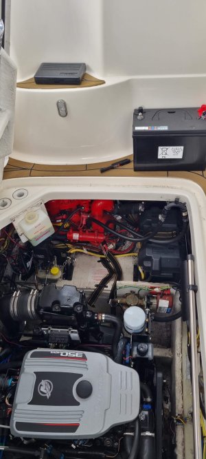

This is a pic I took last autumn when I went after the fuel pump and filter as I took the first battery out.
As you can see, there's a fair bit packed in there. After looking at pics and chatting with you guys I'm thinking the best option is to get it out. I'm hoping it's the carb and an easy fix, but if it's not, it's already out for a mechanic to look at. To get it out I'm thinking that by removing both batterys, probably the ac pump on the bottom right i might be able to wriggle it free.
Vas. You mentioned earlier I'm worried about disconnecting the genny itself, I'm worried about the lot lol! Its more of a confidence thing to be honest. But chatting with you forumites it has encouraged me to get stuck in and get the thing out!
I spoke to a mechanical minded pal earlier and he said to steer clear of carb cleaner on a boat with 150ltrs of petrol nearby!!
Parts for this genny (westerbeke 3.0kw) are not easy to come by and what I can find is from the US for big £££

How much does it weigh ?
Just looking don’t leave the battery terminals lying about ,you dont want any sparks. Also when working leave the vent fan on.
