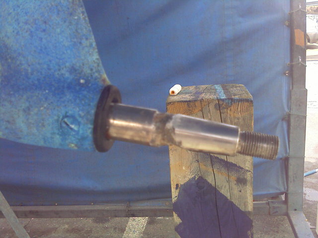

I had something similar, also showing under the cutless bearing and under spots of antifoul, there are pics of it on Vyv Cox's website. However the shaft material is quite strongly magnetic and Vyv guesses it's made from 4 series rather than 316. Jeanneau penny pinching presumably.
