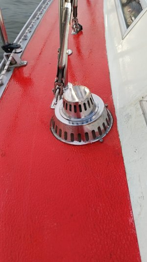

I lost the stainless steel 'top hat' to my heater exhaust on deck ... whoever installed it - used the three screws around outside to 'hook' it down ... I go across Baltic in heavy weather ... away it went !!
For sake of a simple lock-down .. I would not be facing having new 'Top Hat' made !
