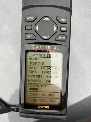

That's odd, my GPS12XL (functionally similar to the GPS12) has version 4.6 software but the date is, as expected, 1024 weeks out of kilter. It shows the date as 14 October 2004. The position is correct though.
Garmin said they weren't going to the fix the problem GPS 12 Time and Date are Incorrect | Garmin Support so perhaps a non-Garmin fix has been applied to yours.
Edit - Perhaps this one? GPSrChive - EOW
