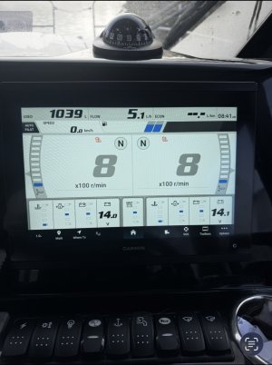

Well, yes and no. Garmin support came back this am saying is not their problem because the rudder indicator is only compatible with a single engine set up but I beg to differ because the boat came with 2 from new and the rudder indicator was there, however, I want to have a go a the Options Menu and see if amending the number of engines does the trick. The thing is that I am not sure if by doing so, the engine display on the Garmin will only read one or have any other effect. It should not because that particular display feeds from the LC5. Picture below for reference. The rudder indicator used to be in the middle of the screen, right between the gear indicators.Thank you for following up.

😂yes, CL5. I had a look at the Yamaha owners manual and the engines I have do not have a rudder indicator per se. How it works apparently is by the engines telling the CL5 their angle position, tilt, etc and the CL5 can sen this info to the plotter which in turn translates this info into the visual representation we see. When the rudder indicator (animation) disappeared, the dealer told me to check my software version as the newer one addressed minor issues and bugs, so I did to the latest one which is 41.05 but it did not resolve the issue. The more I think about it and trace my activity customising the plotter to my needs, the more I think there is a chance I pressed the wrong button somewhere inadvertently perusing something else that took the rudder indicator out of the screen. I am back at the boat on Monday so I will have a go again. Thank you for the above suggestion.👍

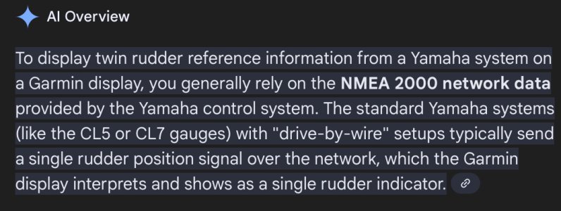

View attachment 203212I see some button pressing in your future 🤣 Not sure i trust AI content but it makes some sense
A ha, just what I was thinking. Shame I never found the above on my quest to resolve the issue. This makes me more and more certain that the Garmin or the CL5 is not at fault, the fault lays with the operator (me) for pressing something I should not have. Maybe I added a second engine to the configurator on the Garmin when I was adding new fuel to the database and this took the rudder indicator out. The above, paired with what Garmin told me yesterday then makes a bit of sense. Stay tuned.
