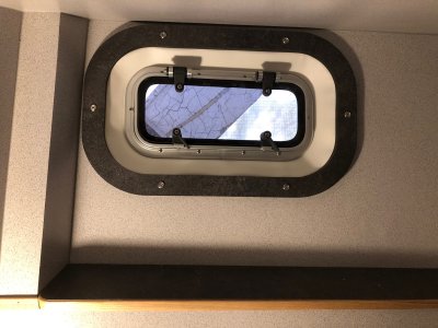

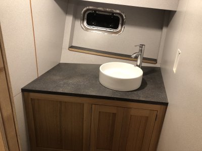

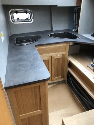

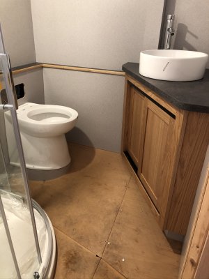

I went the laminate route. I’ve used the same laminate to trim and finish many other areas within the boat so as to create some consistency with the finishes. I’ve used a matt/satin dark slate type pattern which I’ve also used for the interior helm dash, worktops within both heads, trim around forward portholes and various other detailing around the boat when needed.
