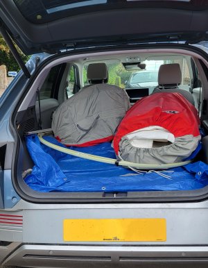

I'm not sure what size of boat you have, and the length of the battens
If it's small, it's probably easier to keep the battens in and roll the sail, then transport it in the car or on a roof rack using a ladder to stop then flexing, as suggested above.
If the boat is big, you have no option but to take them out, the sail will be too difficult to handle.
At some boat size there will be a crossover when the sail is too difficult to manhandle, then taking the battens out makes life much easier.
The lower batten on my boat is over 5m long, so it won't fit inside the car without being bent, and it is surprising how far you can bend them.
The photograph is of the main and self tacking jib load in the car, jib on the right, main on the left, with the main sail battens bent through 180deg. They go from the footwell on the passenger side, you can also see the rod battens for the self tacking jib.
the main sail is about 75square meters, and weighs nearly 50kg, the jib 55 square meters and weighs about 40kg.
I'm 76 and and with thought and careful handling I can rig and de-rig both sails and get them into and out of the car, single handed.
