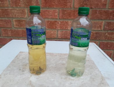

Would you use this aged (2 years) petrol?
It smells the same, evaporates with no residue and burns the same on a teaspoon test. It has had been stabilised with Startron fuel stabilser since new and mainly E5. The older petrol is the slightly darker colour and compared with fresh E10.

If I ever have question about fuel - then I just mix with fresh ...

Those three items help to preserve the fuel .... a few shades darkening is a factor that in reality would not normally affect its use.
