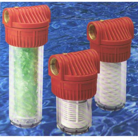

MapisM
11 Mar 2002
20,493
Yes I do, before (and inline with) the water softener.
But it's rather bulky (see below), and I was thinking to use something smaller for the boat, hence this thread.
Anyhow, if your Q is meant to understand if around here it's common to get grit from the mains supply, well, while at home I usually open the filter self-flush every 4 to 6 months, and judging from what I can see inside, the grit would hardly fill a tea spoon.
Otoh, as I said, on the boat we're talking of several years, rather than just a few months...
