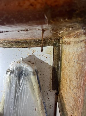

I envy those able to remove the glue remnants with power tool! It’s taken me four weekends to remove the ‘gloop’ from a failed previous re-headlining of our heads. No idea what glue they used but it failed this summer turning to icky goop. Used lots of goo gone to get rid of most of it before being able to use a wire brush on a drill then acetone to finish it off.
So, for those contemplating replacing their headlinings, DONT skimp on quality glue!
