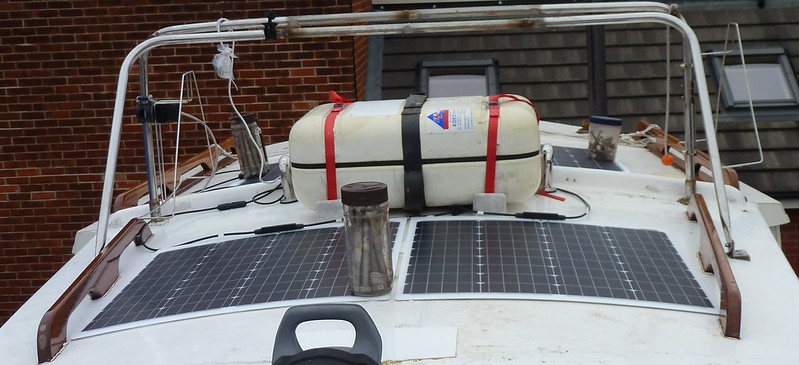

Polysulphide. That will retain them in position and avoid the mistake of using Sikaflex. Sikaflex is an adhesive and if you need to replace the panel it can only be removed by mechanical means. Removing the polysulphide would not damage the boat.
This is on my other boat:
solar panels ext by Roger Gaspar, on Flickr
The weigh is to help the panel to the curve until the first stage of the cure. Note the second large panel at the back also retain the curve for the panel. You don't need screws etc. For Tiller Girl I have used Velcro which has work fine.
solar panels ext by Roger Gaspar, on FlickrThe weigh is to help the panel to the curve until the first stage of the cure. Note the second large panel at the back also retain the curve for the panel. You don't need screws etc. For Tiller Girl I have used Velcro which has work fine.
