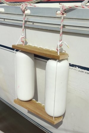

We saw this idea on a boat in New Zealand and nicked it. The fenders are relatively small ones that are used mainly to keep the tender off the hull. The carpet-wrapped steps with the blue polypropylene lines are used when the boat is lifted out by crane to keep the strops from crushing the toe rails. I always like things to be dual-purpose!

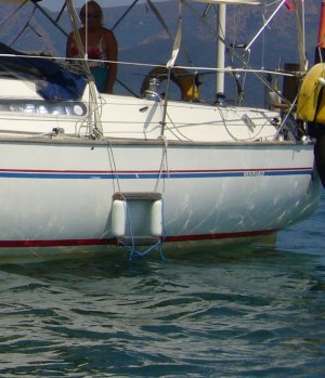

This is a Plastimo product. It hangs higher on my freeboard to be above pontoon hight and swings aboard on a line, when underway.
The ladder is very effective.
Just copied the idea too :) I added two antiflip dyneema lines for the steps.

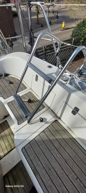

Similar to the Lalizas boarding ladder I have that clips into deck sockets .. folds away when not in use ...
I have never fitted the deck sockets - they look like Key slot plates ... I just hook my ladder over the rail.

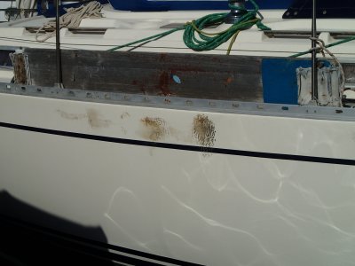

I have used fender socks for 30 years or more and never suffered any hull damage as a consequence. In fact, just the opposite, they clean the topsides quite nicely. Conversely, berthed in Tinos for a week in very rough conditions against a boat with unsocked fenders we suffered considerable damage to our topsides. No photos of that but here is one showing similar damage from bare fenders.P7060149.JPG

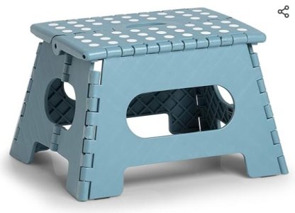

I have one of these foldable steps, useful to climb onboard but also for sitting during the odd dish laundry washing/working on the pontoon. Tied to the boat with a lanyard to avoid forgetting it :)
My wife is vertically challenged and we saw one of those Ina Chinese store looked just the thing,for a small boat the Dufour 24 has hightopsides🙁
