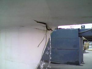

It will be a fairly old boat, and I believe J/Boats were early adopters of resin infusion techniques, which I think were used on the J/120.
Thats all correct. I've done lots of miles on one. I recall being in a bunk one night with the boat slamming through some heavy weather convinced the keel would fall off.
Crack looks odd to me for a wave; unless there had been a previous grounding.
Then again, I’m not an engineer.
Guessing the ensuing investigation will throw some light - if published that is.
Looks uncannily like this one.
From a 2008 J/120 failure. Internal matrix failed apparently. Read all about it ... J109 J120 stress cracking in keel hull connection

Very sad if caused by an inherent defect in construction however I haven’t read of J keels falling off unlike certain other makes which seem oft quoted with this issue.
Me neither but the SA thread linked above detail three j/120s, two of which certainly had the same problem - and that was thirteen years ago. It also mentions redesigns and a refit program for other models.
