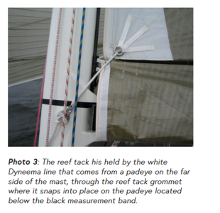

I used to pass a length of line trough the reef tack gromment and around the boom. No hooks, no spectacles.
I had intended to fit the following simple system to my boat but never got round to it before I sold her. It seems simple and logical to me.

Poignard's system is all very good by in my case the line goes from pad eye (we call them a saddle) through the cringle back to another padeye or cheek sheeve down to deck to t a turning block and back to cockpit to be treated like a halyard. 2 line reefing all done from cockpit. Repeat for second reef. All assuming if you have slugs on luff that they can be released somehow. (I use a bolt rope only so pulls out easily)
I prefer to see the cringle pulled right in close to mast and boom. Mast especially to get luff tension pulling luff close to mast to remove load on luff rope and slugs. ol'will
