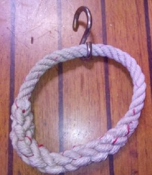

Spectacles were much much better for me. The previous set of sail just had the cringle. In a blow, getting the cringle under the horn could be a challenge.
I made this thing to help hook/unhook the cringles/rings to the horn, one can pull with both hands it works quite well, I keep it at the mast. Loop dia about 15cm
