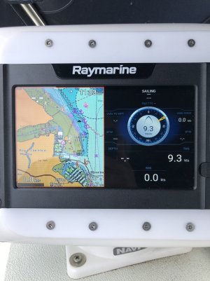

This was our choice when fitting a new Element 9 to the existing EVO 100 wheel pilot and ST60s. The only bit I missed was the need to use a converter cable from SeatalkNG to the Element which like the Axiom takes NM2000. The ST60 Seatalk to SeatalkNG widget is in the cabin ceiling. Note, read the instructions for this carefully, it requires the Seatalk red power cable to be cut and isolated because the converter is now going to supply the power to the ST60s. Also try to put the power supply to the network in the middle of the cables. I bought a cabling kit plus a converter kit which gave me most of the bits I needed and then e bay for a couple of extras to keep the cost down.
Works well and updates to all the EVO100 components plus Element, are now done quarterly via wifi.
