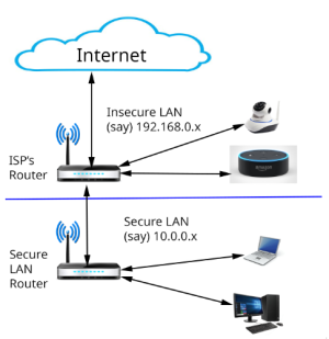

Sorry Bigplumbs - a little drift to help.
This subject is actually quite relevant to your OP.
My setup is this:-
The Internet Service Provider's router forms the "Insecure LAN".
I then add into that LAN another router which creates a second LAN (the Secure LAN)
The Secure LAN has its WAN port connected one of the Insecure LAN ports.
So, for example, all the devices on the Insecure LAN would have their IP addresses in the range of 192.168.0.x
And (again for example) the devices on the Secure LAN would have their IP addresses in the range of (say) 10.0.0.x
The second (downstream router (the Secure LAN Router) has a WAN port that connects to one of the LAN ports on the ISP Router.
Something like this:-
The devices on the Secure LAN can reach the Insecure LAN but devices on the Insecure LAN can't reach the devices on the Secure LAN.
On my system, my downstream router is flashed with OpenWRT which, being Open Source, can be audited/checked to ensure that there are no nasty back doors etc.
Sorry for the thread drift but, as I say IMO, this IS relevant.
I hope that helps people - I believe this is a very important subject.
