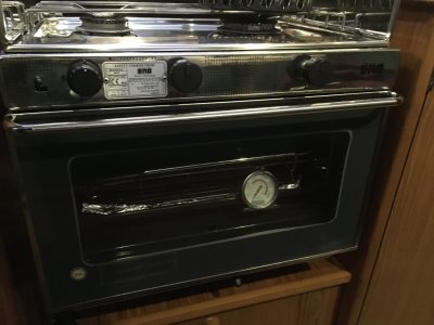

This one, on a 1999 Jeanneau?

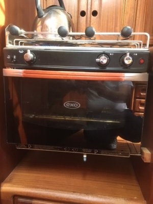

This is my oven
Measurements are 43cmx 35cm 4mm thick with a small radius on each corner. There were no holes in it.IMG_3083 (2).JPG
This is the bracket I made for it from a metal with holes in that I got from B&Q. Was meant to be temporary but 6 years later I still havent got round to doing a proper job.
