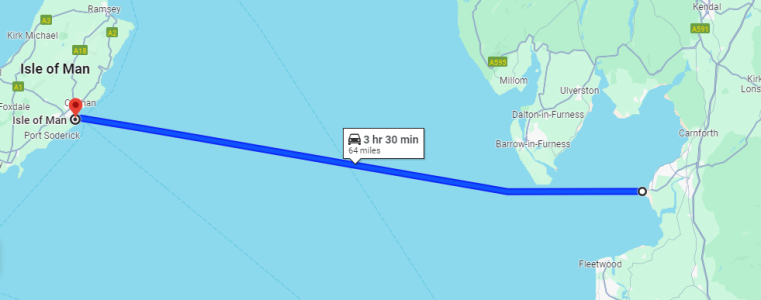

I'm thinking that I'd really like to do a trip to the Isle of Man (like in the screenshot), but my boat is not very big though (4.95m), which is this.

I am absolutely not attached to that starting point... I typed a location into Google so I could get an image for my post and it added all sorts of routing so I just cut out the waypoints. I definitely agree with shortening it where possible.

In the kind of weather you'd do it in, you'd be doing 20 knots so hardly any point in starting from somewhere else just to save 45 minutes or less on a 3 hour journey.
Ideally flat calm and windless but force 3 or less. Blue on windy.com

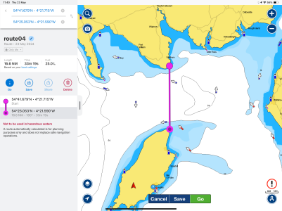

Drop in at Whithorn then it’s only 16 miles of “open” water and you won’t lose sight of land
Head for Ramsey then follow the coast “if you’re heading for Douglas”
Tides can get a bit rapid round there but time it right before high tide and they ease off.

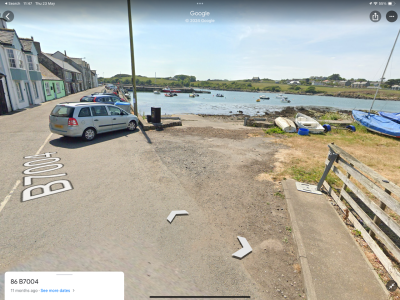

Slipway at Whithorn
