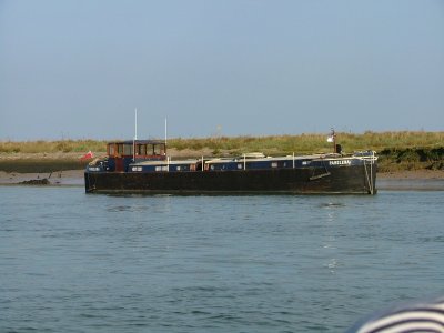

Parglena is 60ft 35ton and has a 120hp Ford, which was ample.
Personally I wouldn't go below 90hp as a decent amount of power gives you an edge especially if you want to go down to the Medway/ east coast.

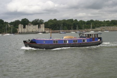

Is that Timothy Spalls round UK barge? I guess every Dutch barge should have a Perkins 135, will out last the rest of it easily.
However everybody has failed the test and not read the question "Engine size needed to cruise a 52ft Dutch barge on the Thames" not a lot of hp required to do 5mph :)

Yes, Tim's boat.going past Upnor Castle.
Had a pair of M135 Sabres in a boat.
Just put fuel in one end and the prop never failed to turn.... ever.
Proper lazy old 6 litre 6 cylinder diesels.
Never a moments trouble and no silly turbos or electronics.
Much better than the frantic delicate little turboed hairdryers in my other boats.
