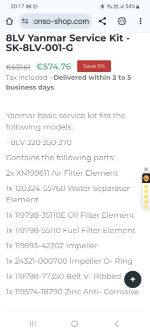

I searched these sites for alternatives for the Yanmar oil filters, fuel filters, anodes, impellers and belts and found nothing. Maybe just me being dense of course :unsure:.
Before I move on let me just say my intention is follow the Yanmar schedule unless someone knowledgeable convinces me it's safe and wise to do otherwise. But for those who think servicing is cheap think again. A 250 hour service kit for one of my engines was €600 + VAT so €720. The oil was €120 and the Yanmar service charge is €360 including VAT. So €1,200 x 2 = €2,400 so €500 per month.

Put up the reference numbers for your original service parts
