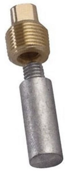

Actually it looks like the connection to the engine block is all via the threads of the brass holder (and there are a few of them) - so maybe even just a light smear of silicone on the first thread or two of the holder?

Unfortunately an "O" ring won't be any use on the set up in the picture in your last post. Possibly a little bit of sealant or even PTFE tape on the last couple of outside threads. I assume you have a new brass holder, could be the threads in the unit are worn.
+1 for PTFE on the last couple of threads. Worked for me on my old Beta which had a similar setup.

Some of the 2000 series have a plugged connection for hot water
the suggestion of new plug along with running a tap into existing thread makes sense as it may have been cross threaded at some time
