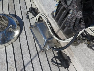

This photo shows how I solved a similar issue. The two sockets for the roving solar panels are Bulgin Buccaneer, which can be had with screw on lids for when not in use.
The stainless steel box that takes all the cables (navigation lights, VHF etc) below decks is called Cableport.
Stainless Steel Deck Cable Lead-Thru only 105,95 € | SVB
Performes similar function as a swan neck fitting, but less of a trip hazard.

I had one of those cable ports on my last boat, good kit.

Search the forum for Cableport and you'll find my link to a supplier..
Great because cables exit horizontally and crew can stand on them with no worries.

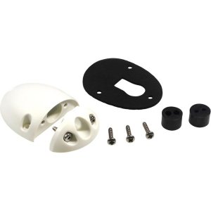

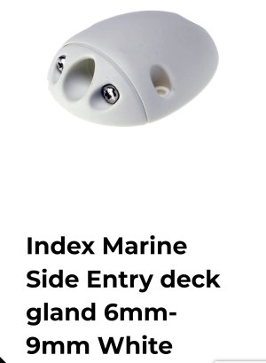

But the cheap option if you want a few flat glands (for example of a couple of solar panels on the transom) would be from Index Marine...
Easy to maintain and cable joints can be made below deck..
They mount nicely on a vertical surface with the cable forming a nice 'drip loop' as it exits.
B27
26 Jul 2023
2,068
Thank you.
I think two of those might do the job and cover up the holes previous owners have drilled.
Under £20 too!

I've also used the Index Marine deck glands which exit horizontally, used on solar panels, also available for twin cables. Excellent glands and reasonably priced and in different colours.
