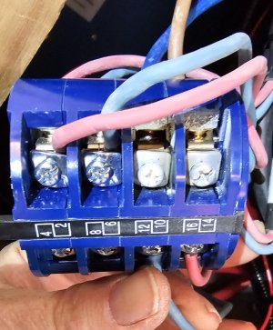

I've used the set-up described above for about 2 weeks now, and it failed. Progressively, intermittent at first, and then completely.
On investigation, it looks like 2 of the contacts have been arching.
The contacts are connected to the output from the switch to the 32 amp RCBO.
It seems obvious that they have been switched under load, and probably a capacitive or inductive load.
I can try cleaning them with spray of some sort, and I will order a new one to replace it.
Is there anything I can do to stop this happening again, besides not switch when the power is on?
Perhaps a diode, or some other spark suppression device?
That is purely a connection block so should be able to carry switching under load. Looks like you have a unit that is defective in some way or bad connections to start with. Looks a bit strange could be more like overheating on the two contacts 10 & 14. but not sure. I note that you have the tail on one side of the pressure plate. Bad idea. You should use crimped terminals that will be gripped by both sides of the plate, equally. or failing that make a "U" in the cable tail. Proper terminals best! ;) I don't think that you need worry about inductive or capacitive loads, or spark suppression devices. Think simple, don't get too technical.
Not sure, as it's under shadow, but it looks like saltwater corrosion is bridging the 10-14 terminals.
When cleaned up, a dose of Silicon grease or Vaseline would be a good idea.
Photograph could be deceiving but it looks like the powdery residue from the overheated plating on the terminals. ? Unit is only two weeks in use and I would be surprised if it had been in a damp or salty environment. But! :unsure:
It not been anywhere near saltwater. It lives under the chart table, and the boat only been on the water for 3 weeks
It does look like it overheated, almost like vaporised metal. It's not been under full load (32 amps).
It now looks a manufacturing fault?
I have a new one on orders, delivery in 3days.
I've clean the contacts, now to try it and see if works, at least for now. 🫰
Thanks for the input.
Just to reiterate, As I said, when you get overheating the plating of these contacts, Nickel, Cadmium, whatever it is, tends to go powdery like that, does look a bit strange. Good luck with it!
I've just taken the switch apart. The plastic has melted around one of the contacts, to the point where the contact fell-out!
Since the switch is only used in the winter, I can bypass it with a choc block as a temporary measure.
I just need to number all the wires so I can put it back together again.
It's a 32amp rated switch.
The maximum continous output from the generator (the smallest Wisper Power unit) is about 3.5kW into a resistive load . Just under 16amps at 12 volts.
The manufacture is JFK, that's what is stamped on the face plate.
Purchased off Ebay.
It looks like 1 bad contact, which melted the plastic separator and caused the adjacent contact to to break free.
The other contacts, which essential take the same load, are all OK.
Purchased off Ebay.
OK, as previously said, does sound a bit like a faulty switch.
My apologies for previous post I mistakenly thought it was just a terminal block not a switch( Should have studied the photo a bit longer)🥴 However, in general comments stand and fully agree with Paul. Defective unit seems prime suspect!
Postmortem, in this photo, you can clearly see the burnt contact which was causing the problem.
The consensus suggest that it is a faulty contact.
Is there anything else that could have cause it? For example a stray strand of copper wire, which found its way into the gap during installation?
The contact was the neutral line and the adjacent contact was the live line, ie a pair carrying the same current, switched at the same time.
It seems strange that the live line contact dosen't have the same burn marks.
I'm just curious, in my professional career I carried out quite a number of Postmortems on failed equipment and systems, which just makes me look a little deeper than the apparently obvious.
Comments?
Comments?
Very difficult to say from pictures but could be as simple as a badly assembled or manufactured contact unit. A little bit of arcing can go a long way😵‍💫 It does look as though it was (is) an internal defect in the switch. No reason for the "Line" contact to burned as that was making good contact. I know where you are coming from with respect to "Post-mortems" I always want to take things apart and find out what went wrong and why. However if you have a good look and cannot see anything obviously different in that contact assembly, compared to the others, I would put it down to a Chinese "Friday afternoon" job:unsure:
Just make sure that you have a good look at the new one when fitting and get all your connections good and solid. See my previous note about crimps or "U" turns in the tails. Good luck!🤞
