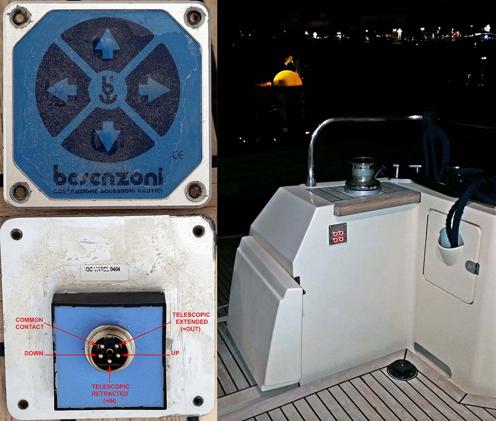

In the cockpit of my boat, I had a rather popular control panel for her Besenzoni passerelle.
It was still working well when I bought her, which means that it lasted 13 years in a somewhat exposed position.
So, I didn't complain too much, when it started not sensing anymore a couple of buttons.
Anyway, what might be interesting also for others is that the panel simply controls four clean contacts, all normally open, with a common wire.
So, in principle it can be replaced with any buttons of your choice, even if the like for like replacement part is still available, for those who want to keep it simple. Otoh, "keep it simple" is not the forum way, is it...? :rolleyes:
Long story short, below is a pic of the OEM panel, together with its contacts.

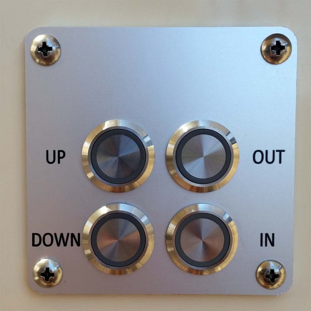

On the right side, you can see the brand new panel which BartW very kindly built for me, with s/steel buttons, rated for external usage and LED lightened.
Makes the OEM Besenzoni panel look like a toy in comparison, many thanks again B! :encouragement:
Looks awesome.
Bart has however kindly left space for 2 more buttons:

You can also connect an after market 4 channel radio remote control to those wires to do away with the Besenzoni infrared remote.
Indeed, good point.
Not so interesting for me ATM, since the IR remote+receiver still works well, but might be worth considering for anyone interested to replace it.

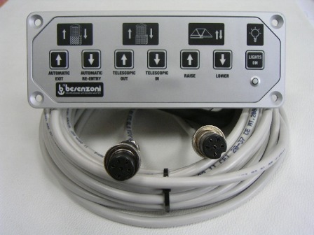

Yes the Besenzoni control panel is naff as it the Opacmare compared to this OEM .........
Pin-craft are a Viareggio based Co .They do a fantastic range of gear inc there control panel .
I have not seen a better quality one yet , OEM or DIY .
There’s curved and bevelled SS and Carbon look too for the weather proof touch pad .
8 buttons the other four are hi low and balcony if you happen to have those as well .

Hang on a minute when you finished lording Timex and seiko take a look at a Patek Philipe range of watch’s :)so to speak .
I prefer Barts panel TBH. Barts remind me of the panel on a Southerly 57RS on the side of the helm pedestals for controlling the keel and sails. Brushed stainless over chrome plated any day for me.:encouragement::cool:

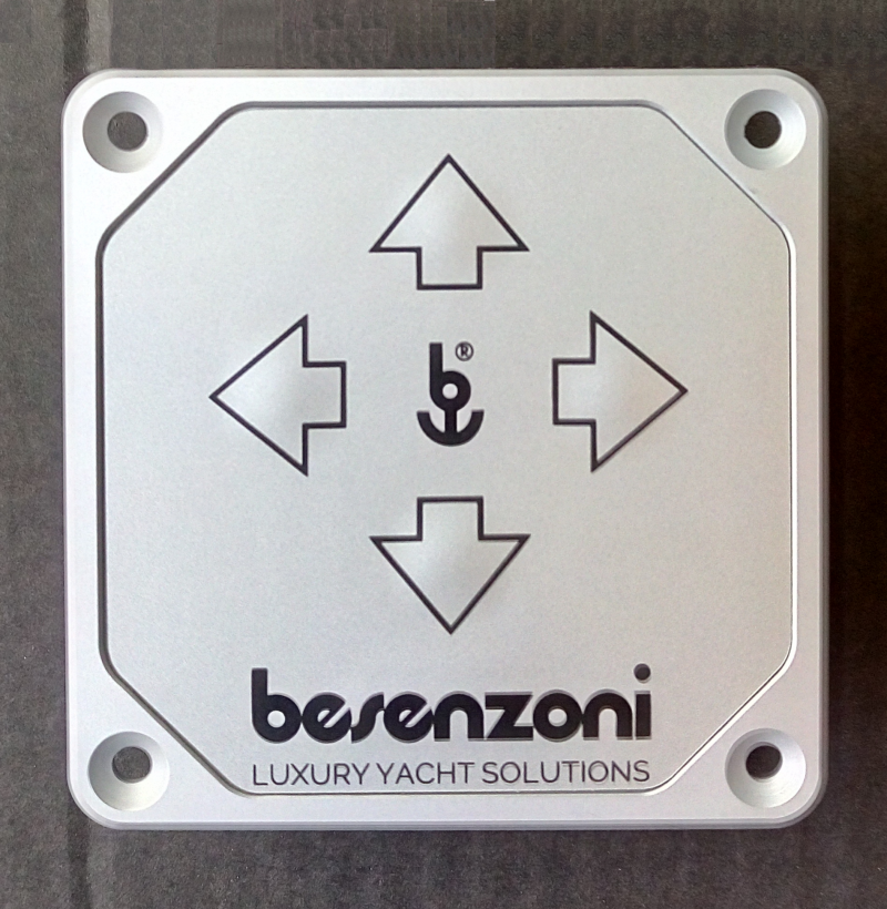

J, I have nothing against the OEM panel - btw, in the meantime they dismissed the blue one in my previous pics and replaced it with the one below, which is more similar to yours and arguably more elegant than the blue one, if you don't mind the pretentious label (I do, TBH! :ambivalence:).
But from a functional viewpoint, lighting aside, the feeling and feedback of "real" buttons is much better.
Besides, I can now press the right buttons without even looking at the panel, for obvious reasons.
This is a better pic, for the records - showing also my small tribute to Carlo Riva, which someone will surely recognize. :cool:

The pic of the pin- craft does not do it justice , the SS finish etc .It looks good with the other SS around in my boat compliments it as opposed to brushed Al .
The four redundant buttons are just that redundant buts it’s a 5 min job to re wire one in to rake over from the four pass buttons if there’s a problem .
Also you actually need two fingers to operate , that may or may not be a safety issue ?
The single illuminated rhs and any other simultaneously.
I like that feature and the fact with it being illuminated you know the main breaker is on in the saloon .
Again it’s a long distance image , I’ll ( if I remember ? ) try to get a close up next week when we are on the boat .
