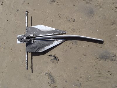

This event had me testing snatch loading of anchors and I conducted another test. I set anchors to 500kg tension (equivalent to maybe 35 knots - nothing special) and then snatch loaded them.
This was the result on a Fortress and an early model of the Anchor Right aluminium Excel.
Anchor Right were appalled at the damage, re-engineered the aluminium Excel and gave me a new one, and Fortress sent me a new shank in their 'no questions asked' guarantee.
