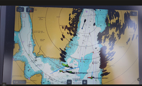

After a summer of use I can report that I’m pleased that I went for the Doppler radar (albeit at negligible additional cost as previously reported). It is a useful addition to AIS functionality, particularly in identifying on-screen those vessels that are not transmitting AIS signals. The red/green colouring quickly identifies to the user which radar echoes should be of particular concern. I’m not sure I’d pay a £1k premium for it though.IMG_2023-09-10-163540.png
After a summer of use I can report that I’m pleased that I went for the Doppler radar (albeit at negligible additional cost as previously reported). It is a useful addition to AIS functionality, particularly in identifying on-screen those vessels that are not transmitting AIS signals. The red/green colouring quickly identifies to the user which radar echoes should be of particular concern. I’m not sure I’d pay a £1k premium for it though.View attachment 163758
What chart package are using on the Axiom? It is very UKHO like.
