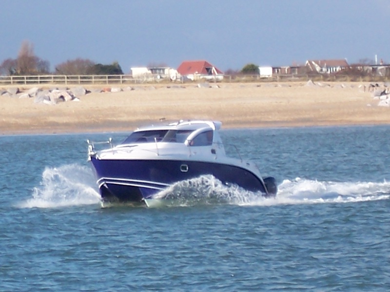

I don't think this cat is on the plane. Looks very much in displacement mode. Also, its got a centre hull.
Now this cat is planing. Hull level and only the stern touching the water
I'm not even sure about this one.. I'd like to see a picture on flat water. But at least we can see that it is a cat with slender hulls forward. Are the aft sections flat planing type or do they continue as rounded forms ?
