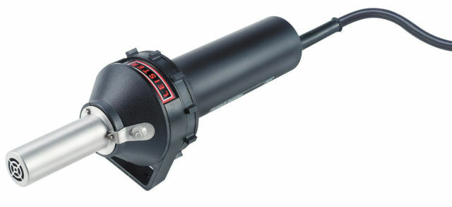

SWMBO bought me a new Leister Hot Jet S welder for Christmas.
One like this:-
url
Being smaller, the new welder is significantly easier to use than my old Steinel one.

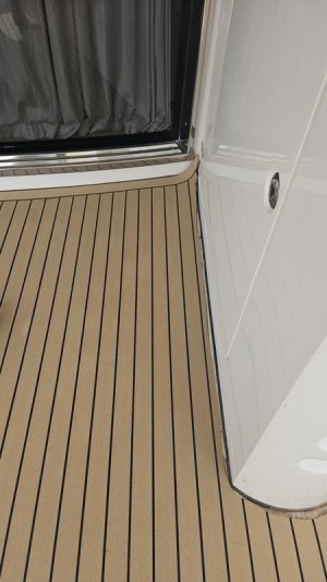

The second phase was the bow and side decks which I made and fitted myself.
Flexiteek isn't available for the DIY industry so I used Trakmark which is a slightly different shade.
It turns out that Flexiteek 2G changes to a pinkish colour over time.
Trakmark on the other hand seems to stay the same colour.
Thats the difference that you saw in the drone photo.
It would be nice to change the bathing platform to Trakmark but there really isn't a need so unless the colour gets worse, I will probably leave the Flexiteek alone.

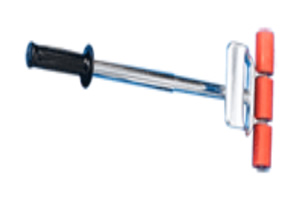

Then use one of these to finally stick it down and get all the air out:-

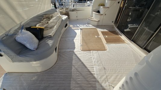

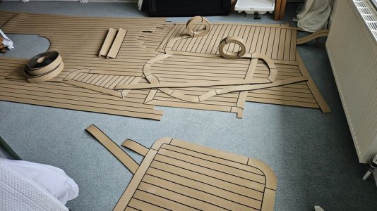

Last autumn, I "Templated" it all up - using the same template material that I use for my sewing projects.
I cut the material and stuck it down with some double sided tape - writing notes and dimensions over the templates.
I also take lots of photos because I make all my synthetic teak panels at home in the UK and I need reminders all the time.

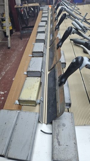

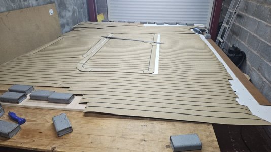

Anyway, I've spent the winter months welding up panels for the cockpit.
In its own way, this phase is more challenging than the previous ones.
In January, I cleared some space in the garage and started work.
Even though it was a bit of a squeeze.
Here is one of the synthetic teak strips ready for welding.
It is vital that any joints to be welded are weighted down - absolutely no gaps.

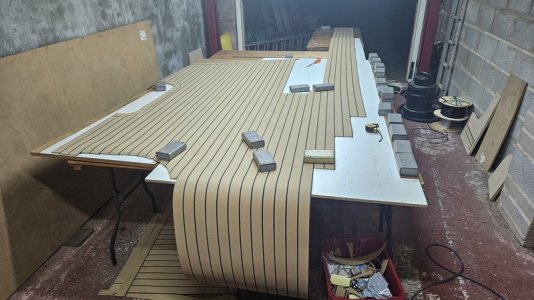

The side deck panels were too long to fit in the garage without opening the door.

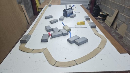

Although it all rolls up nicely, I've made it in five main sections plus the hatches and borders.
My thoughts are that I will weld the borders in place when I get down to the actual boat.
At the moment, the panels are roughly cut (within 50mm) of the edges.
The process will be to put the panels in place and then lay the pre-made borders on top.
Then mark/cut/weld the borders into the panels.
That way, it has a better chance of fitting.

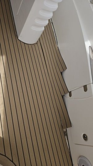

It is a huge problem making this kind of thing 1000 miles away from the boat and expecting it to fit when you get there.
This is the border that will (hopefully) fit around the flybridge stairs.

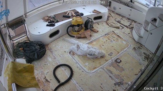

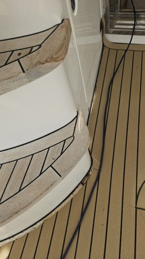

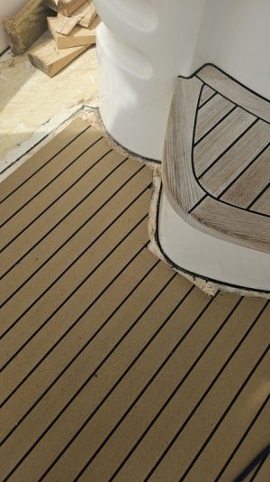

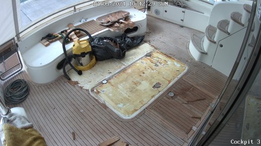

Last week, a local contractor in Sant Carles started the horrible job of removing the old wooden teak from Jennywren's cockpit.
You will notice that I'm not there - these photos were taken by JW's cockpit security camera.
That was last week - this is today's progress.
As to be expected, there is some damage to the GRP that will need to be repaired and the whole surface smoothed out before we fit the new synthetic teak.
I have asked the local guy that is doing this for me to finish the job using the panels that I've made - assuming they fit!!
I hope you find this interesting - I will add more photos over the next few weeks - IF it all works!!!

Arrived here in Spain 36 hours ago but it was raining most of yesterday - nice and sunny today (I bet you can't say the same for the UK today!!).
Worked inside the cockpit yesterday doing the rough cuts and I'm quite pleased with the way it is fitting.
As I said, it is difficult doing this kind of thing 1000 miles from the boat.
I will take some more pics later today.

As MapisM says. There is a lot of prep work that needs to be done after the old teak has been removed.
Particularly where the old teak was screwed down.
I also have about 9" square where water has got under the first layer of glass so that needs to be broken out, dried and re-glassed.
But it is good to get to these areas now before they become a bigger problem later.

Photos as at lunch time today.
I'm please with the overall fitting - made from templates and extra measurements taken in January.
Just rough cuts so far
From this
To this - border strips are made and waiting to be welded in.
In fact this border was done after the photo was taken.
