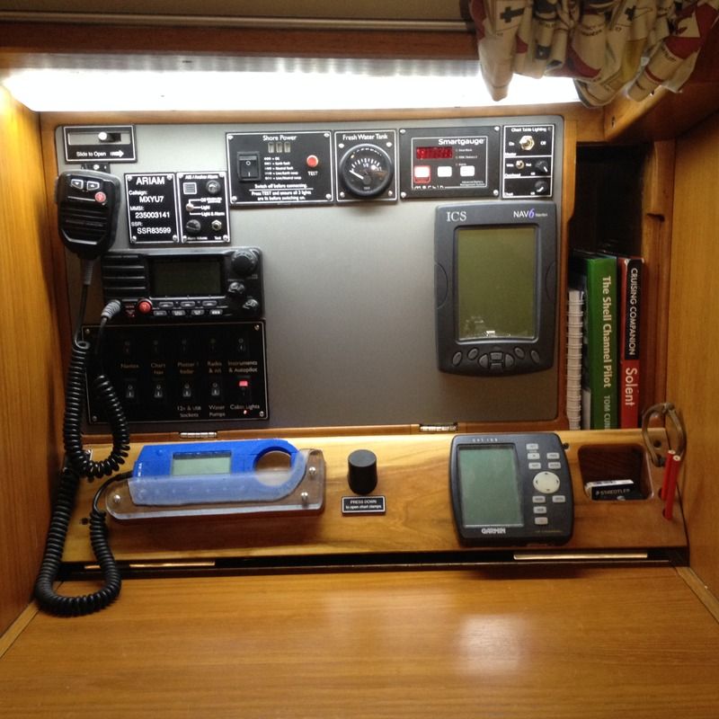

When I rebuilt the back of Ariam's chart table (including the woodwork, bookshelf, lighting, etc), instead of having one big panel etched I designed a series of individual ones that could be mounted on a grey plastic board:
(Sadly the picture is a bit out of focus, and you might need to follow the Photobucket link and use the zoom button to see the panels properly)
http://i1168.photobucket.com/albums...7-C458-43E0-B24F-8F321FBCA412_zpsa7n6w6ow.jpg
