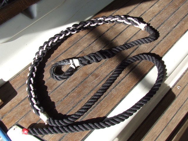

If you are using conventional rope (i.e. not braid) you can thread some shock cord through it with a marlin spike. It works very well.
My wife does a variant of that and it is very successful. Your first attempt will probably look a bit amateurish, but you'll get better. It has the advantage over the big lumps of rubber that it does not add to the weight of the line which remains general purpose
May I ask what the variant is? thanks
Well, given that Gunfleet's description was not very detailed, is is possible that she does exactly the same as him... She takes three lengths of shock-cord - about a metre each. With a marlin spike, she opens up the lay of a three stranded rope and slips the end of one piece of shock-cord under. She then works down the rope in a straight line, feeding the shock-cord over and under alternately till she has it all laid in. She then repeats the process with another length of shock-cord one third of a turn round the rope and lays in the remaining length another third of a turn round. Finally, she tidies up the ends and whips them down - the result is a small bulge in the rope, but it gains a significant amount of spring. I have seen other people do versions where the shock-cord is threaded into the weave in a variety of spiral patterns - they can look more artistic, but they seem to be a lot more work and I see no evidence that they work better than my wife's simple approach.
Well, mine are not as neat as your wife's sound nor those of Roberto below. I'll have to tidy up my act! If you can get the one piece thick black shock-cord it lives longer. And using thicker rather than thinner shock cord also helps. Sorry if my description was bare boned.
