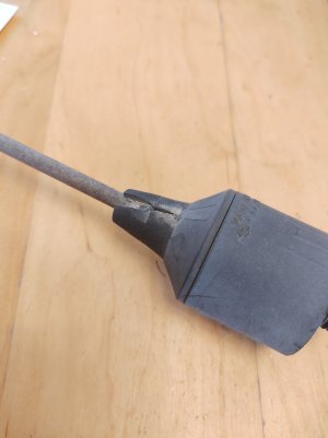

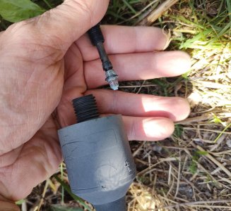

Having had a V-Tronix ss whip fail through water ingress at the whip (and taking out the coax with it), if Metz aren't all that, are there any makes that are decent ~ what do you use? Many thanks

Thanks. I won't be buying the one with the inbuilt hawk, again, as it was that aluminium sleeve that corroded and split open the casing top.
The other disappointing thing is the proprietary coax connector, which means that your stuck with their rg58 and from my reading here and elsewhere, it's worth getting something better.
Also worth noting it's a vampire tap (a pin that pierced the cable). They're not meant to be disconnected and reconnected.
