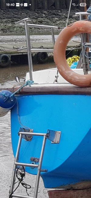

I was thinking to place it near where the fender is. Is that a good place? The diesel heater is located right at the back and there is access.
top corner of the transom seems to be a fairly standard place to fit it. I can’t imagine any issues.
Yes, I think that is what I will do, and I will bung the hole when sailing.

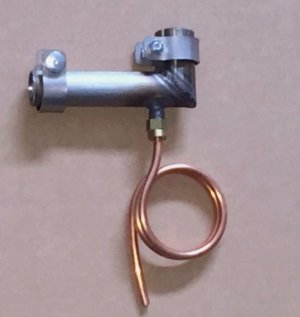

You should have an EXHAUST DRAIN ELBOW at the lowest point in your exhaust.
Like this

The bungs sold for resealing wine bottles after you open them fit nicely in the standard heater exhaust fitting.
I don't think that would get past any reponsible health & safety check.
Fir the proper exhaust drain instead.
This one is for sale on fleabay.
