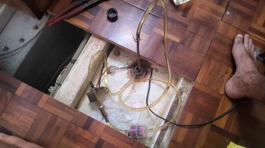

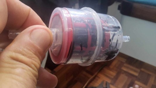

It's been about 12 months since I last cleaned the sludge out of the bottom of the diesel tank. My little fuel filtering system does a great job. I buy cheapo filters off Ebay and discard them at the end of the job. A one metre length of copper 8mm pipe goes down into the tank and can be bent to get to the corners if necessary. The copper pipe connects to some clear fuel hose then the filter and Ebay fuel pump and back to the tank.
Not much sludge this time but satisfying to remove it and know it won't block the main filters.![received_1138769344203154.jpeg received_1138769344203154.jpeg](https://ybw-data.community.forum/attachments/122/122210-80aaebfe49288e77dfba1d7fe56ff66f.jpg)
