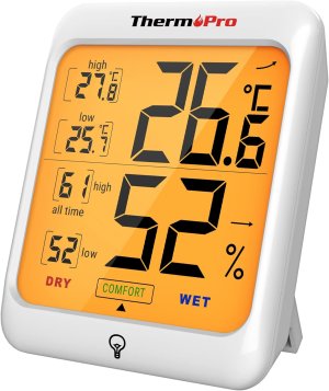

looks like I'm getting a Maeco dd8 - and I'll add the Thermpro monitor as well Wonkywinch
