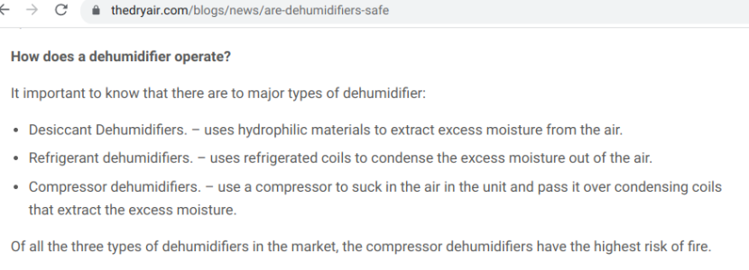

Then maybe you would prefer another source which indicates the compressor type to have the greater fire risk

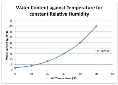

I set my Ebac unit on medium automatic and that seems to keep the RH below 55%.
The heater will help, one to protect the dehumidifier against freezing temperatures and second to raise the air temperature to enable the dehumidifier to extract more water.
The ability of air to hold water falls with temperature (which is reason for condensation on cold surfaces). I aim for min temp of %C and max RH of 55% in the boat. That seems to be working, albeit boosting MDL's profits.
Need to fact check that, aren't the second two the same thing? As someone else says, the compressor doesn't suck air over the coils, a fan does that, the compressor cools the coils which is surely how the second item is described. The internet is a dangerous place for fact checking.
Especially forums
Any way I see this as low risk regardless of the type of dehumidifier .
Desiccant type are however said to be better at low temperatures which is when they are needed on a boat in the UK climate.
