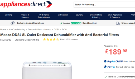

I have had the Meaco dd8L since 2017 and have used it on the boat every winter with no issues. The lowest fan setting and the 'one drop' humidity setting is sufficient to keep everything sufficiently dry.
The price is £20 more than it was in 2017

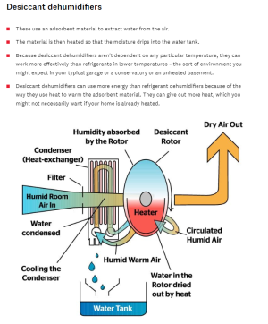

I used to run my old compressor dehumidifier on a time switch but desiccant types like my new one don't like this and I have to use a low setting, as others have mentioned.

Dessicant/desiccant work well at low temps whereas compressor type don't. I believe also less likely to cause a fire than compressor type. I've had an Ecoair DD1 for 5 years & live on full time, it's still going strong & makes a world of difference. As johnalison says they have a shutdown cycle so shouldn't be used on a timer...
