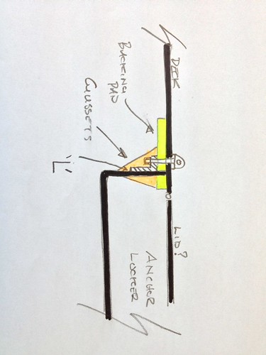

Not on this year's list, but at some point I'll want to fit the storm jib stay for which I added a mast tang while the rig was down. To help me decide when to do it (ie, how much time will need to be set aside) I want to get a handle now on what's likely to be involved. Rigging the stay itself is straightforward, I know what I'm going to use for that, it's fitting the padeye on deck for the bottom of it that I need some help with.
The boat has a modern-style anchor locker, sealed off from the accommodation. The aft bulkhead of the locker looks to be in about the right place for the padeye, so will form the basis of the necessary reinforcement. The trouble is, I don't really have a feel for how much reinforcement is likely to be needed. The boat (a 34' 1998 Maxi) is relatively lightly built, certainly compared to my little tank of a Crabber, and I don't want to be doubting the forestay attachment in the sort of conditions where I'm likely to need it.
The basic plan would be a pad-eye on deck, with an inverted L-shaped piece of stainless below with the pad-eye bolts through the short leg of the L, and the long leg against the anchor locker bulkhead and bolted through it. I'm guessing I should first add extra fibreglass to the bulkhead, and possibly the deck. I've done a certain amount of glassing by now, but none of it really loadbearing in this way. I don't have much of a feel for how much I need to add. The bulkhead only extends about 14" down from the deckhead, then it curves under to form a shelf in the locker and foot-room in the cabin. So it could stiffen the deck, but not directly transfer load down to the hull.
Any advice, rules of thumb, design principles, and photos of similar jobs are welcome.
