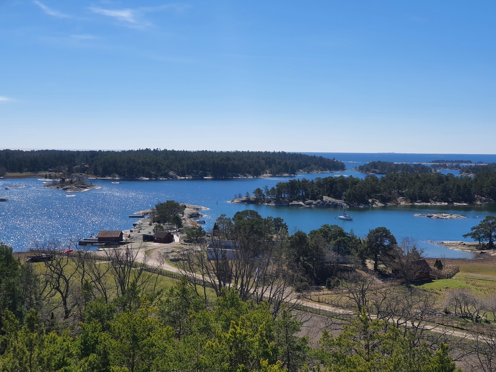

Swedish Cruising Association (SXK) has a lot of member buoys and even some island harbours peppered around the whole Swedish coast, usually in very scenic places. Members can stay for free for a night per buoy. And even if not a member, at least keeping the locations in mind is a good idea, as usually there is space to anchor as well.
Here you can see us sitting on one of their mooring balls:
(Stendörren nature reserve)
